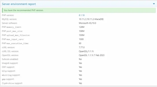

I'm my host. As far as the php logs go, there's nothing. Does it maybe return false because I'm running via IIS?
There are some reports about that, albeit being ancient.
It might be because you’re running on Windows. There’s a comment about a config file path needing to be passed in on Windows, we probably don’t support Windows edge cases like this (I didn’t think Windows itself even officially supported PHP any more).

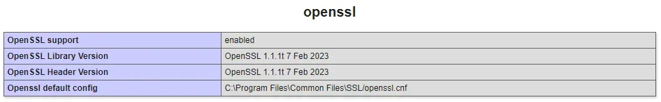

That's strange, because, according to phpinfo, OpenSSL is working just fine:
Update:
Found the "fix". C:\Program Files\Common Files\SSL\openssl.cnf did not exist. So I copied over PHPs openssl.cnf and it installed.
No idea, just going by what the comment says on php.net there. I don't have any Windows machines to test with.
