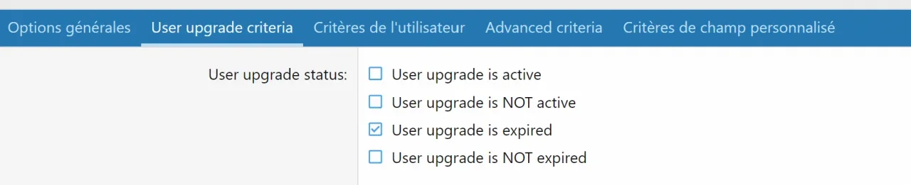

Hello,
I use the add-on for a while now but I do not find the solution to send an automatic message just after the expiration of an upgrade.
My goal is to send the message within the 2 days AFTER the upgrade expiration.
I do this in "User upgrade criteria":
How to define a date criteria in order to say "the account is expired for 2 days" in order to send this email only afer expiration and not a recurring way?
Thanks
David

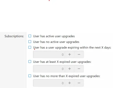

Hello David,
I'd suggest looking into downloading our [TH] User Criteria Extended add-on as it adds some advanced criteria into your forum which you can use on multiple add-ons such as [TH] Monetize. I have investigated the above and found a type of criteria for Subscriptions (for Monetize) that you could use. Take a look at the criteria under Advanced Criteria and see if any of those fits with your use case.
Have a look! Hope this helps :)
Hello Dalton,
I have already installed the [TH] User Criteria Extended add-on.
It seems that it does not really add useful criteria for my needs :
My need is to have a criterai allowing to filter on :
"User has an upgrade expired for 2 days"
Thanks
David

I understand as it was just a suggestion to take a look of course. Either way, this type of criteria isn't currently supported.

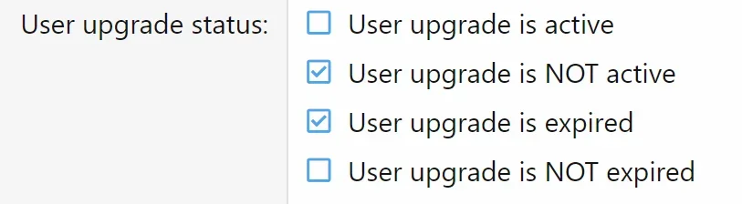

Hi Dalton,
Thanks for the information.
So I try a different way.
I would like to send the message to all members whose the upgrades have expired.
I do it this way :
It is strange, nothing happens when I use this criteria.
I have of course several members having expired upgrades but this selection send just no messages at all.
Do yo have an idea about the mistake I might do?
Thanks for your kind help
David

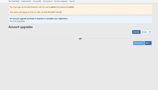

how to configure the amazon links? i am using the demo of your website, but i don't know how to do it
I'm also trying to understand how the plugin works, but I only get this when I generate two subscriptions
This is because it defaults to Monthly and it looks like neither of the subscriptions are monthly - I'll try and add some checks for this to select the correct tab by default.
Yes please solve this, I don't use monthly so this leads to alot of confusion and lost revenue
@est3ban129 in the meantime I just setup a redirect
/account/upgrades -> /account/upgrades?filter=all
That ensures people actually see the memberships...
We have a new version of this ready to go which only shows the filters if there are both monthly and annual upgrades available, and also includes an option to disable the filters even if you do have both types. This should be released shortly.
