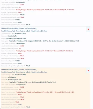

Anyone noticed an increase in the time taken to register by bots recently? Definitely getting more that take longer now.
Reaction to the recent registration timer update in 1.1.4?
I haven't seen a new release of XRumer to accommodate script pausing on registration yet (I would expect it to come in this or the next release, and we're about due a new XRumer release)...
A new version of XRumer is usually released every 1-2 months, and they last released one mid Jan March 2013:
botmasterlabs.net/events/
7.7.42 was release on 19th March (which isn't mentioned above)
7.7.42 was mostly about making it easy to create Hotmail accounts and beat more versions of CAPTCHA
It could be a strange coincidence, but I've seen quite a lot of bots now taking longer
Some of them always use to take a while due to slow proxies / slow server response, but there is a bigger number now
The only explanation I can think of right now, is that botters are using their more successful proxies, and these proxies happen to be the slower ones
The ftjply043+tuya001 botter has more than 15 thousand proxies (and they are the ones I know about)... some botters are very serious!

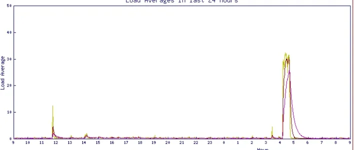

Had an alert last night from my server at the load went through the roof!
First thing I checked was the spam logs. I've got 4505 registrations attempts from the same e-mail address "enosdgpy @ hotmail. com" from IP address 58.22.155.218
Sounds like you need to activate rate limiting per IP address on your web server :)
I already have, but this wasn't picked up.
This is a snip from CSF alert showing apache processes
