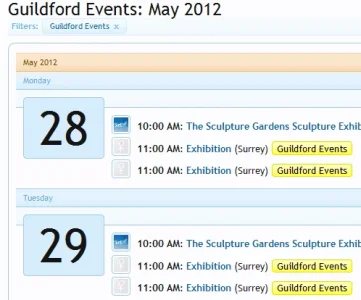

It is very similar to what you do on your surrey forum, except that we would need a kind of "overall" filter for "regions" or "cities".
You have done something very very nice with jaxel's "events" plugin on the surrey forum, where you added Prefixes to the events. Making those events "filterable" by a dropdown is just a awesome quick way to show only the events which interest me.
For the xenkingdir addon such a filter-handling of prefixes is what we are looking for.
Simple example for your surrey forum, is somebody who wants to see all directory addresses related only to the "guildford" region. In our case it would be somebody searching for addresses in the "costa del Sol" area. Since some of those "prefixes" are NOT preciese locations, but more like regions or areas, using a prefix for filtering ( via dropdown ) would be what we are looking for.

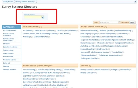

Wow Tenants, This update is amazing! Thanks a lot for the prefixes , this makes the directory work perfectly for us now. Excellent work!
Allow me to ask for one little improvement in any of the next updates and one question:
1. It would be nice if " Filter by Prefix " box would show up in the main directory page.
This way we could see e.g. only "Guildford related entries" right from the beginning.
It could look a bit like this :
2. My question, is about the wording used currently.
Currently the prefix box is labeled:
Filter By Prefix:
can I change the wording of this e.g. to " Filter by Location " or " Filter by Area " ? - If so, which text template do I have to edit ?
Would be great if you could help me with both queries. Again, Thanks for your great work.
