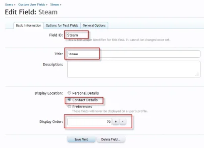

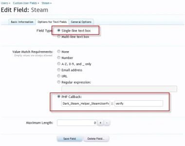

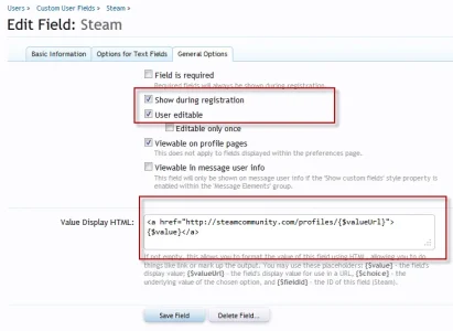

Same here. The problem is the installer assumes the Steam custom userfield to already exist, and does not create it if it does not.
Here's how to set it up manually:

Ok, I think I got an idea of what is happening.

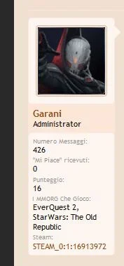

First all you have to go to the Users >> Custom Fields select Steam and go in General Options. You have to make sure that the content is Visible in User Info in Messages. This makes sure that the content gets correctly carried over to the default template. The output will be:
As you can see the Steam ID is there in raw form and it is a clickable URL.

And there you have it! With Xenforo 1.1b4 works like a charm and you don't need to do much, other then to work on the PACE_CONTAINER template. And I believe that we can work around that as well, but I don't have the time tonight. You can see the end result here: http://www.eqnomadi.org/forum/threads/nuova-casa.4073/ Garani is either online or off-line.
