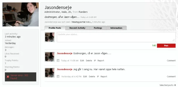

Known Issue(s):
  • It is possible for Cron.php to time out if you have open_basedir set other than none or safe_mode on. This is because it has to load XML data as a file instead of a string.
  • Having open_basedir set other than none or safe_mode on can cause 302 errors on the Steam Profile badge. This has to do with the that project using CURLOPT_FOLLOWLOCATION.
    • The steam login integration still works fine, this only affects the steam badge on messages and the profile.
    • This issue is external to this particular project (not Morgan's code). I cannot find a work around as of right now. I'll see if I can notify the developer, but no promises of a fix for this as this is outside the scope of this add-on.
