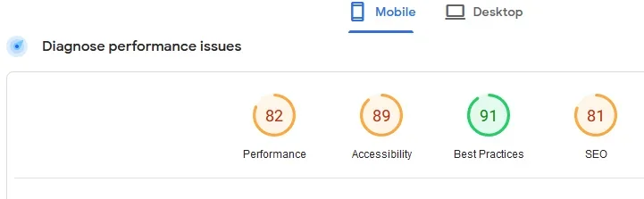

But with Litespeed addon gone the site gets a slightly lower Lighthouse score (93 down from 99 :( )

I also installed this add-on today.
My desktop scores are all 100 but the performance score on mobile is quite low.

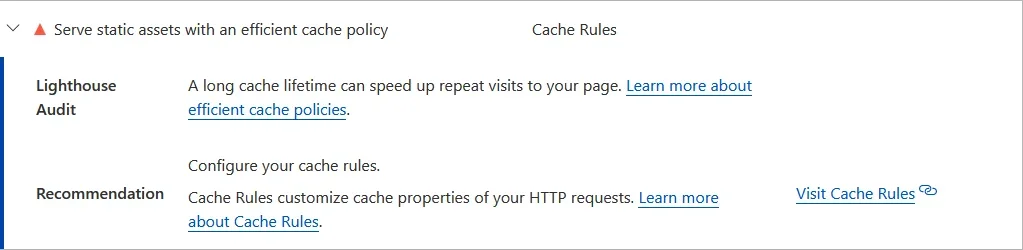

It gives a warning like cache images, css, js files.
Is there a solution for this? :(

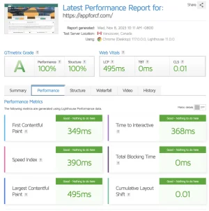

If it's purely just caching pages for non-logged in users (I assume that's what it's doing because it would be pretty weird to be caching pages for logged in users showing their avatar and username as logged in), there's better ways to do it than a cache sitting on your origin server. For example Cloudflare (or other CDNs) can have the cache stored in the hundreds of data centers around the world, so the cache can be served much faster (from the closest data center to the user). For $0 (at least in the case of Cloudflare).
No matter how well you cache something at the origin (your server), a user could still be 20,000km away from your server and you can't fetch the cached item faster than the speed of light. So putting the cache closer to the users is always going to be a win.
You can see an example of XenForo's HTML being served from Cloudflare's data centers here: https://appforcf.com/

my results other than my performance scores are 100. but the performance score never goes up, especially on mobile.
no matter what I do.
@digitalpoint
I have litespeed installed on my server.
When I checked it from cloudflare according to your information, the score seems to be low due to the above problem.
Do you know any way to solve this?
Thanks
If they are items served from your server, ya... you can control the network edge cache of static assets via Cache-Control headers from the web server. For example if I hit my origin server directly, you can see that Nginx is giving a Cache-Control header that says the JavaScript file can be cached for 31536000 seconds (1 year):
twin1:~ # curl https://localhost/js/xf/preamble.js -k -H 'Host: appforcf.com' -I
HTTP/1.1 200 OK
Server: nginx
Date: Wed, 08 Nov 2023 18:33:02 GMT
Content-Type: application/javascript
Content-Length: 7307
Last-Modified: Sun, 11 Jun 2023 16:51:10 GMT
Connection: keep-alive
ETag: "6485fb7e-1c8b"
Cache-Control: public, max-age=31536000
Accept-Ranges: bytes
That Cache-Control header is what instructs Cloudflare to go ahead and cache it at the network edge (in their data centers). A normal request for the same file (passing through Cloudflare):
HTTP/3 200 OK
Age: 17
Alt-Svc: h3=":443"; ma=86400
Cf-Cache-Status: HIT
Cf-Ray: 822fee1f6c897cf2-LAX
Content-Encoding: br
Date: Wed, 08 Nov 2023 18:37:57 GMT
Etag: W/"6485fb7e-1c8b"
Server: cloudflare
Vary: Accept-Encoding
So ya.... the key thing is simply being able to set the Cache-Control header at your web server. I don't personally know how to do it with LiteSpeed (I don't use it), but I'm 100% sure it can be done if it doesn't simply do it automatically be default.
