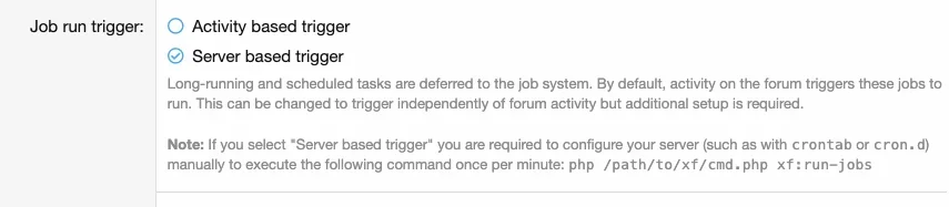

It simply means your site is not getting enough visits to trigger the jobs automatically.
You can create a CRON job to run every minute to run the process.
ACP->Setutp->Options->System & Performance
Look for the server based trigger.
You will need to create the CRON job in your website hosting control panel or from CLI of the server.

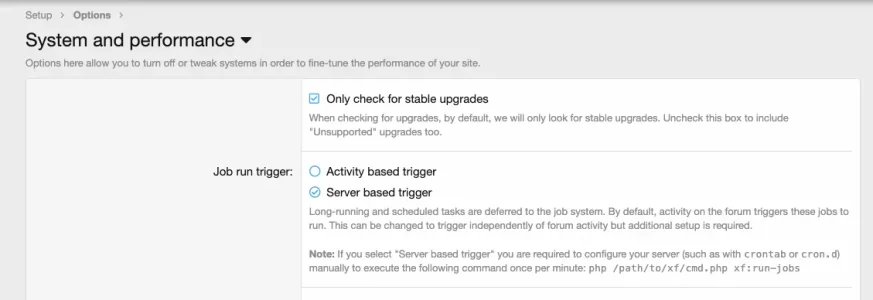

Thank you so much, I went to ACP->Setutp->Options->System & Performance option but can not find server Job run trigger option there.
I can see an option at the bottom Enable advanced mode. but when I click on it, it does not expand or open anything, Enable advanced mode button is not clickable :(
I don't know what's wrong as I just changed my hosting server, my new server meet all the requirements also. :(
You should be able to see that option if your account is set as a super admin.... if not, I suggest you submit a ticket for support to Xenforo.
That screenshot I inserted is direct from XF 2.2.13 as a super admin from
I came back here to say thanks to you for your replies, I did solve the issue buy buying the 1 year license extension and I upgraded my site now everything works fine :)
