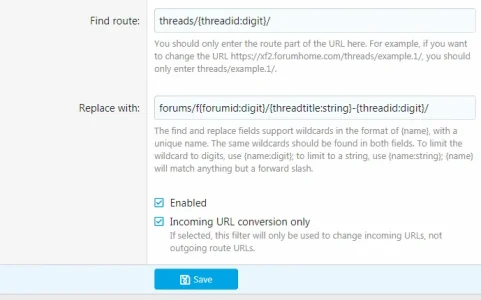

I created three route filters:
Find Route:  threads/{threadtitle:string}.{threadid:digit}/
Replace with:  forums/f{forumid:digit}/{threadtitle:string}-{threadid:digit}/
That one works and captures 95% of the threads I need to capture.
Find Route:  threads/{threadtitle:string}.{threadid:digit}/page-{page:digit}
Replace with:  forums/f{forumid:digit}/{threadtitle:string}-{threadid:digit}/index{page:digit}.html
That works fine too, but I think the number of posts per page on my old forum doesn't match the new XF install, so the content on page X of a given thread on the old forum might be different from the new XF forum. I'll have to double check that so threads have the same number of pages.
Find Route:  threads/{threadtitle:string}.{threadid:digit}/post-{postid:digit}
Replace with:  forums/f{forumid:digit}/{threadtitle:string}-{threadid:digit}/#post{postid:digit}

Route filters are normally used to replace standard XenFor URL format (Find route) with and new one (Replace with).
When a requests hits the server, they are processed in reversed order.
As the rule is configured to only become active for incoming requests, it does work fine; it obviously wouldn't work for replacing XenForo URLs
though.
