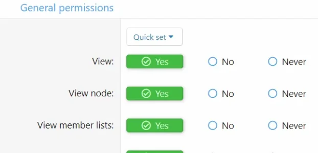

Another permissions question:
Under group permissions I see view and view node .... node = forum from what I've seen.
I've turned this on and off and not noticed a difference. What is it intended to accomplish?
View is the main view permission for the whole site.
Thanks Brogan. So, If I check NO for view for one user group. and a forum member is also in another user group with View set to YES they would still be able to view the forums. Right? That is why I did not see an impact.
Since this permission is at a group level what is the difference between View and View Node? They seem the same.

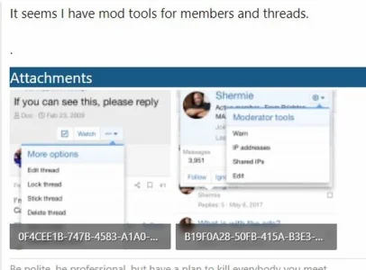

The saga continues. I worked on other issues with new forum and the user who could see the staff forums cannot see them any longer. However he has mod tools for members and for thread. I have went thru analyze permissions and he is set to NO for all mod areas. I am at a loss as to how he can have these permissions. He is only in regular user groups.
Check for node and user level permissions.
Thanks Brogan. Didn't analyze permissions check at user level? And Node is new to me. I think of Node as another name for forums and do not understand the difference or where would check for node level permissions?
If a member is not in any moderator group how he can have moderator tools when some of my mods can't find them escapes me. As I said XF is new to me and I'm sure I'm missing something. Thank you.
