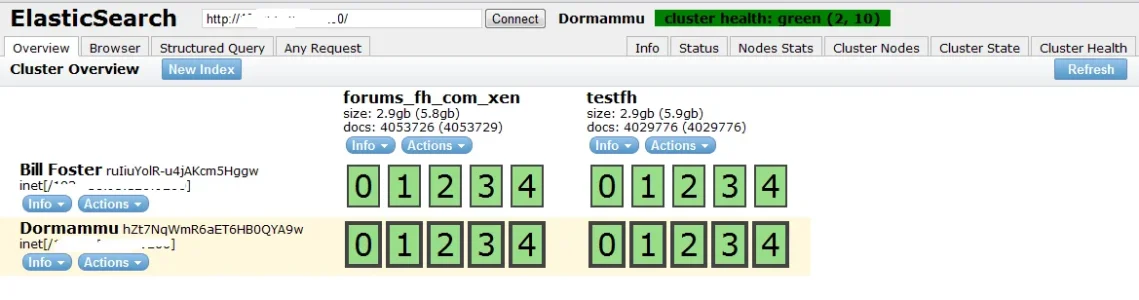

Some stats from my forum....
MySQL index:
8.7K 2011-10-20 20:51 xf_search_index.frm
1.4G 2012-01-10 12:56 xf_search_index.MYD
3.1G 2012-01-10 12:56 xf_search_index.MYI
The same content indexed by ElasticSearch:
docs: 4053718
I have allocated 4gb to my JVM running ElasticSearch to ensure that it does not run out of memory to service my index. The 1.4gb of RAM used by the MyISAM index file has been reclaimed to increase the memory allocated to InnoDB on my SQL server.

Sure, how are you pulling your exact numbers from ES though? the service wrapper doesn't come with much documentation :)

Here is a screen grab of my cluster... (the second node doesn't always stay active, only when I am playing..)
