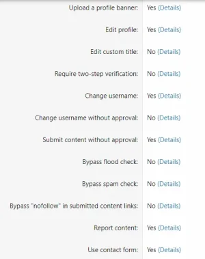

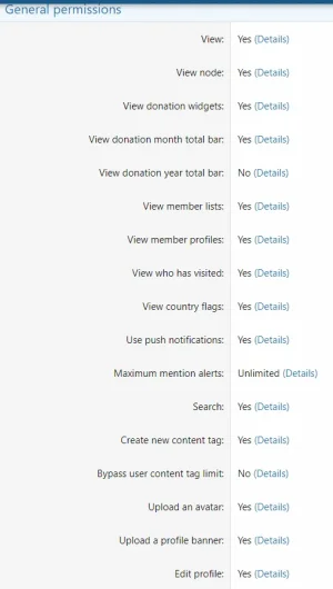

Have you looked in ACP > Groups and Permissions > Analyse Permissions for that user? Sorry if that is too obvious but you don't mention it and that is usually the first thing to check.
Believe me at this point nothing is too obvious and I am at a loss as to how to fix this.
I just looked at the Analyse Permissions for that user? again and this is what it is.

Permissions can be set also at the node level, or each. We have some that are public, some private for registered only, and some only for certain usergroups. I assume you know this already.

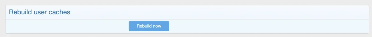

Going to post this here in case anyone isn't reading the thread on my add-on [Andrew] Moderator Panel.
If you installed version 1.9.0 of [Andrew] Moderator Panel then you will need to upgrade to 1.9.1 to prevent the issue from happening. After you upgrade then rebuild user cache and it will correct any impacted users.
