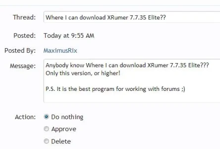

I've never had any problems with spam before but when I checked my forum today I saw lots of spam threads. Some were in Russian though many were in English.
I checked some users and they had fully validated their account using Gmail. The spam is undoubtedly automated though.

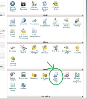

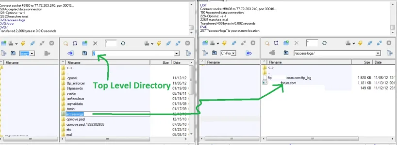

On my system I can look at the Access Logs on my server via FTP, they are located here:
or via CPANEL:
Once you have the logs open (I would open them with notepad++, since some editors can crash when opening large text files) search through the logs for the IP address.. then find the point at which the bot registered... where did they do this?
