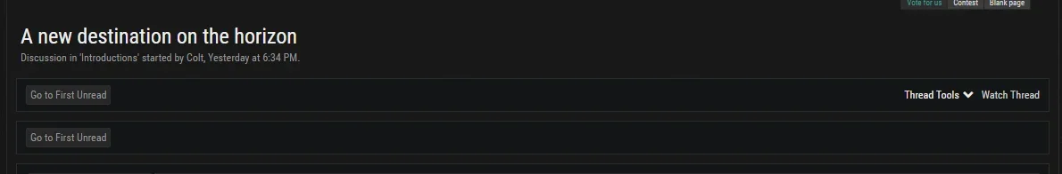

Some of the forums posts are not loading as normal. They are showing in the forums list, but when you open the discussion, the discussion in blank and there are no posts visible.

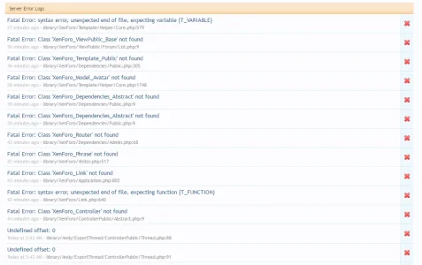

I most certainly could do that, but honestly the support at my host is not the best.
Sounds like an error from xenforo end though. Probably something from the way I transferred the files and databases, I'm thinking something went wrong there..
You need to be able to see php errors, temporarily.
If you have your own php.ini file then you should see the setting. There is a way to enable it in .htaccess but I don't have experience with it.

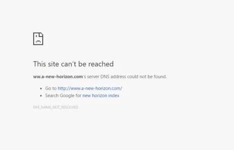

Everyone is now getting Page not found "ERR_NAME_NOT_RESOLVED"
I contacted the support for our host, and we were informed that this an issue with the application.
DNS not resolving is definitely not an application issue, but your example shows you loading "ww" not "www" so that's probably the issue there.
Otherwise, these errors look like a bad transfer of files and potentially the database as well. While you can reupload the files, if the backup/restore wasn't 100% complete (which might explain the missing posts), that can only be resolved by going through the process again.
