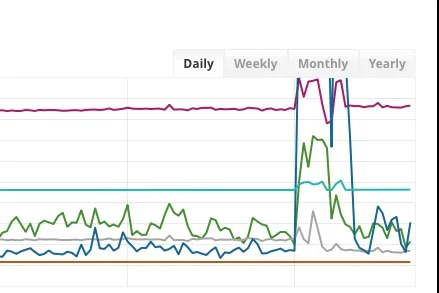

A bit clunky getting it installed... seemed to take up a whole lot of processor intensity (all add-ons disabled). A bit weird... but once on, extremely efficient, doesn't present the issues I had with it last time, doesn't seem to affect thread postings and such that it did last time. Early days... but so far, huge improvement. Nice job.
Oh... LOVE the automated rebuild to get it at a starting point for use.

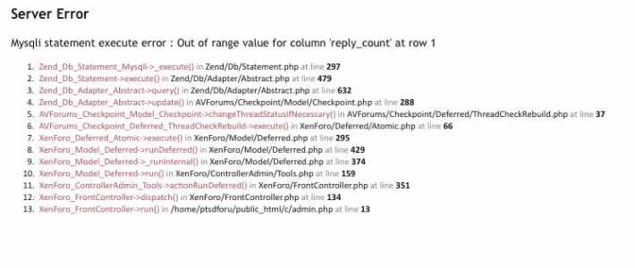

Ok... just got an error when running the ACP rebuild:
Error Info
Zend_Db_Statement_Mysqli_Exception: Mysqli statement execute error : Out of range value for column 'reply_count' at row 1 - library/Zend/Db/Statement/Mysqli.php:214
Generated By: anthony, A moment ago

Yeah the process for migrating the data from the old version to the new version is pretty intensive. It took a long time on AVForums to do ~20 million posts! It is worth it, though :)
This is the same issue that @Fred. had.
I'll send out an update now.
Chris D updated AVForums.com - Moderator Checkpoint System with a new update entry:
Fixes error on rebuild
It seems to be a very common occurrence in other forum software to have threads which have no posts whatsoever in them, e.g. not even a "first post" and essentially just an empty thread container. This scenario can cause errors during rebuilds so that has now been fixed.
