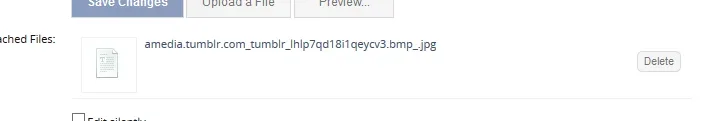

Why is the attachment like this:
And it doesn't display in the post. If I go to the URL of it, I can see it :|
I can't think of any reason for that. What's the BB code of the post? Can you point me at a live example? URL of the original image?
Eh I just needed to check the FLUSH FLAG box and it fixed it right up :)
