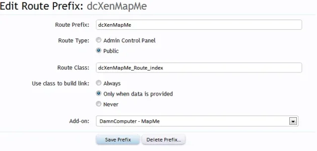

Next question - have you set up a route prefix to point to your controller?
Yep, my route prefix is set up as
and dcXenMapMe/Route currently contains

Okay, that's looking good for the router. I'm actually having trouble understanding what is going wrong - could you give me a simple expected behaviour vs observed behaviour synopsis?
