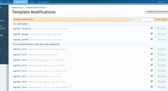

Nope, it uses the core template modifications on the template "register_form", so if you have also added it to the same template (TMS or other method), there should be no conflict
FBHP uses regular expression to pinpoint the exact node and field to replace, so other fields can be added else where in the template without issue
#<fieldset[^>]*>[^<]*<dl[^>]*>[^<]*<dt[^>]*>[^<]*<label for="ctrl_password.+ctrl_password(.*?)</fieldset>#siu
There is an option to use a different template, but this is un-ticked by default (and only needs to be ticked if there are conflicts with other add-ons, which should never really be the case), @russoroni may need to untick this option (if they have it ticked)

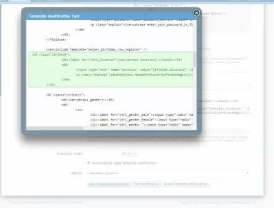

It looks like you are using Simple Replacement to search and replace this:
<xen:include template="helper_birthday_row_register" />
That's fine, fbhp leaves this completely intact in the register_form template when used with template modifications
And from a quick test, it looks like the template modifications should be compatible
