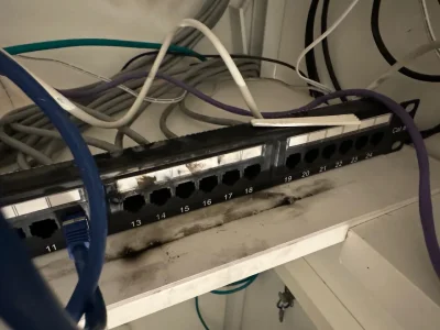

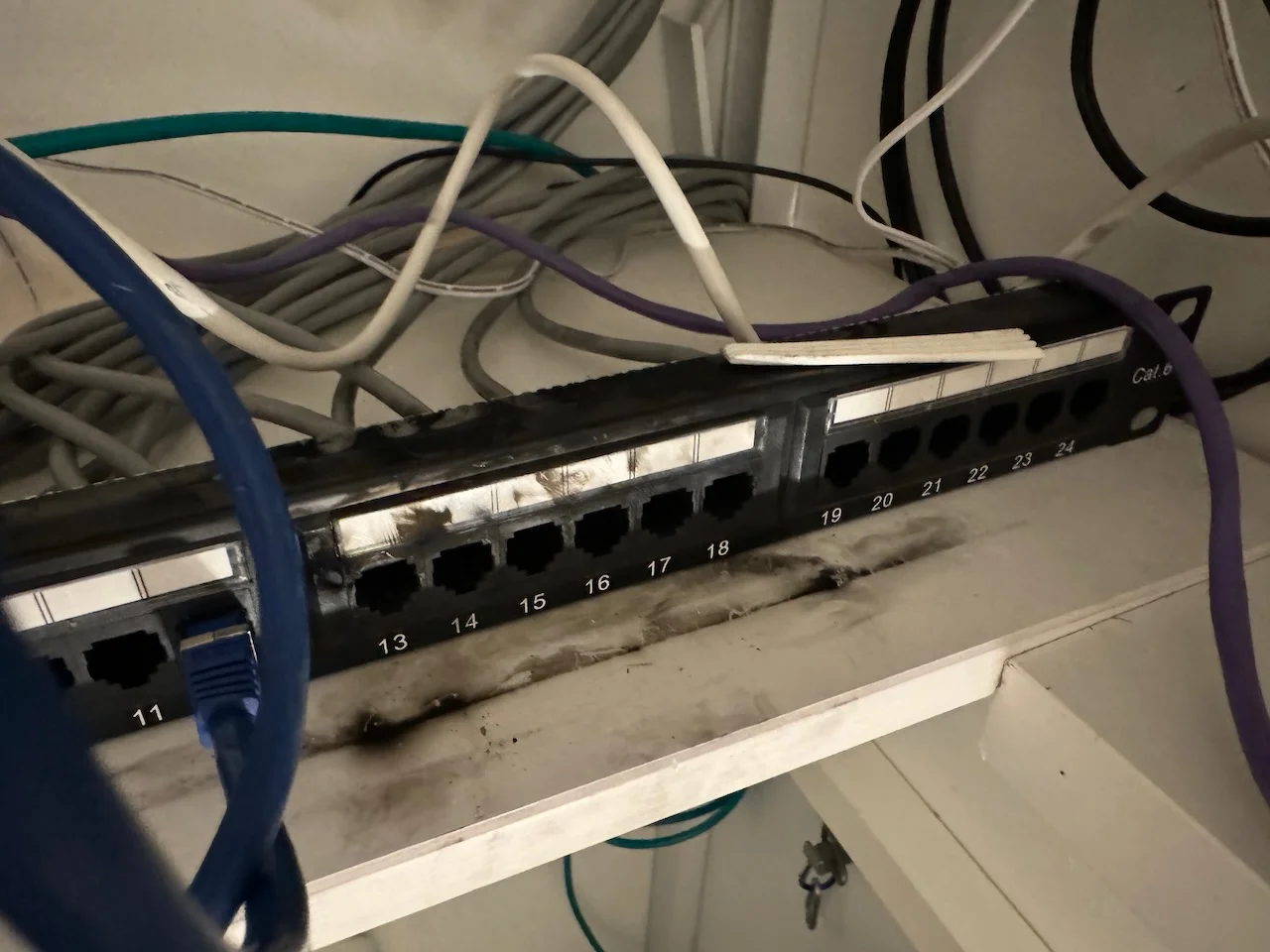

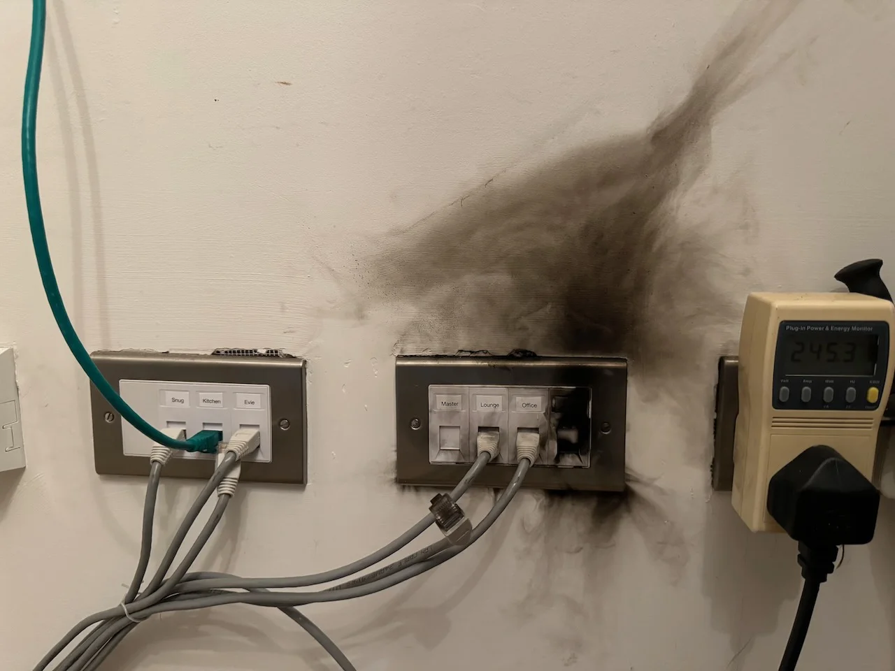

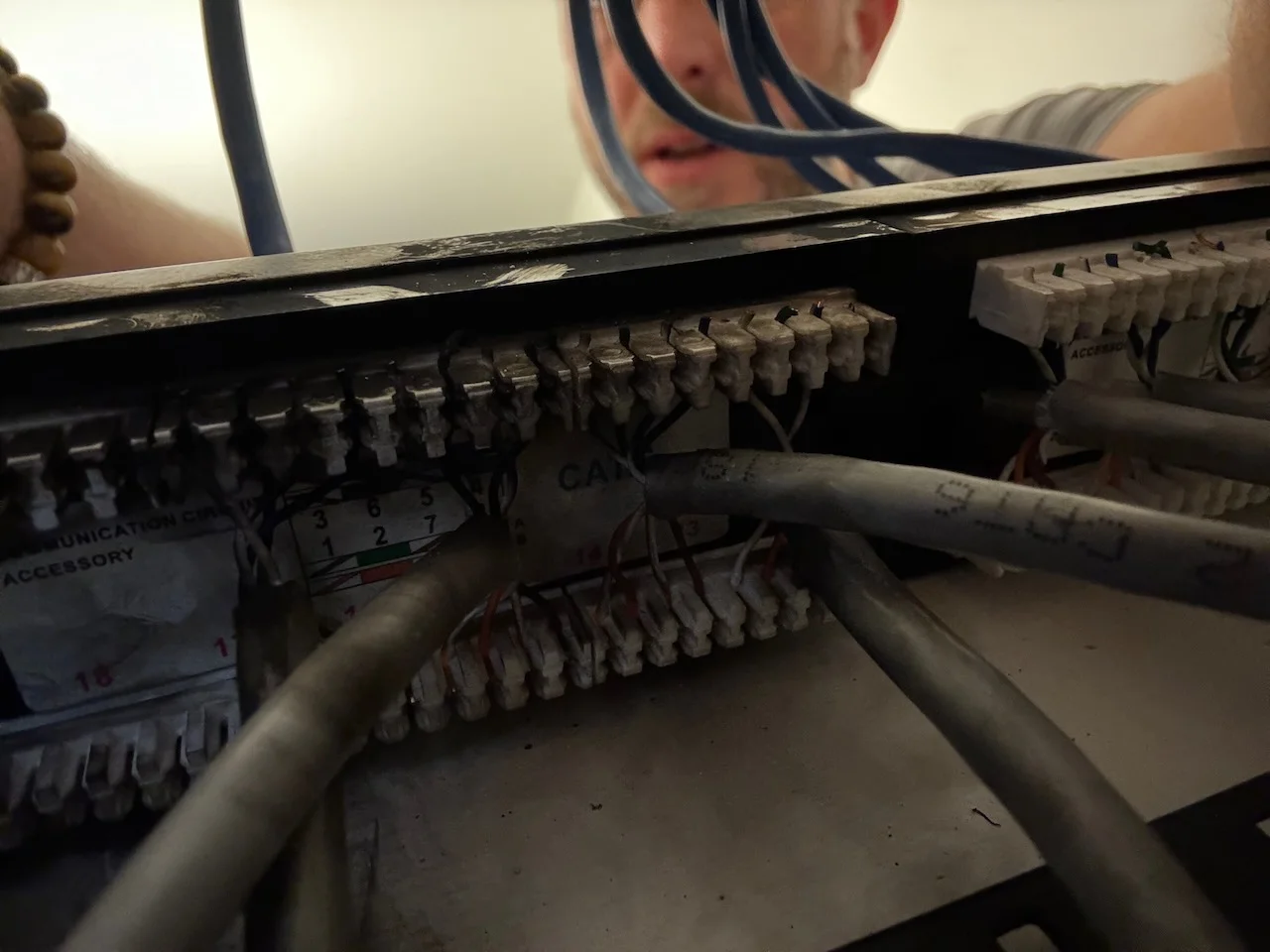

Started to rebuild the data cupboard and found some more evidence...
