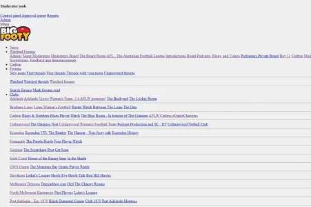

When Installing a completely new style as a separate child of the default style, is the system supposed to rebuild all templates and kill all styling on all other existing styles during that rebuild?

Installing New Style killed Old Style's styling during the Rebuild Templates process.
Question for those in the know: should this happen? If so, can the software be updated so it doesn't happen?
