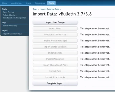

Then you will be taken to the list of import modules. Run each module in order:

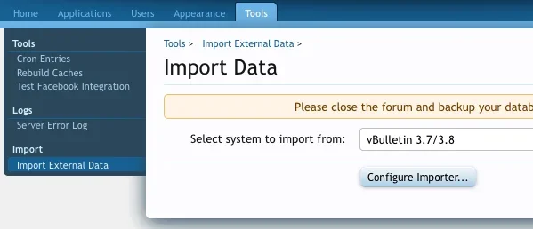

Once xenForo is installed then login to the Admin CP and access the importer:

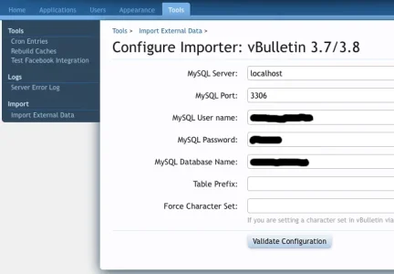

Once you have selected the source system then click Configure Importer. Fill in the mysql connect info for the vB database and click Validate Configuration. You will find this information in vB's includes/config.php file:

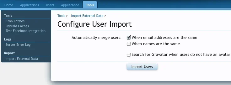

Most of them run without requiring any input from you, except for the Import Users module which has merge options to resolve username and email conflicts:

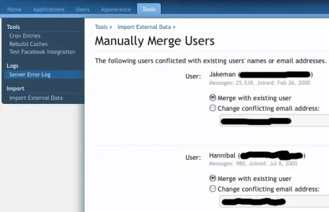

If you opt not to automatically merge users then you will be allowed to manually deal with conflicts at the end of the user import:
It is important to note that xenForo requires a unique email address for each user. If your source forum allows duplicate emails (as vB does) then conflicts will be reported for those users. The importer will require you to either merge those users or change one of the emails. You may wish to deal with those conflicts in vB before running the import.

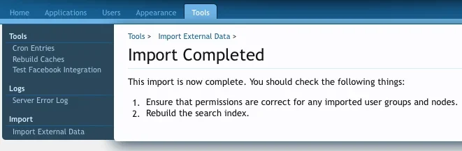

When you have finished running all of the modules then the importer will do some cleanup and present you with this page:

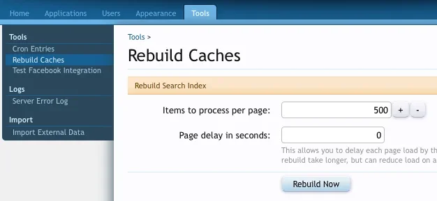

You should do as it says and check the forum permissions and rebuild the search index:
Rebuilding the search index can take a long time on large forums, so plan accordingly. You may wish to run the rebuild overnight when traffic is low.
