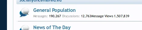

Almost..... Not there yet

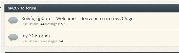

I just install it went to Admin->Tools->Rebuild Forum Views -> run and shows only 7 views.. I'm probably missing something.. Any help will be appreciated
Also there is no views total in nodes

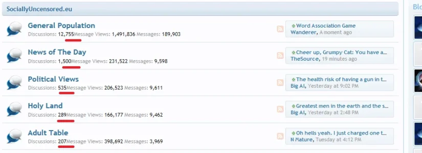

SOLVED
This was a lot easier than I originally made it out to be. It was as simple as changing a language phrase (really it was that easy).
AdminCP > Appearance > Search Phrases > Search for iwdrp_total_views_forum
The default is of course: Message Views
For me I simply added 1 space before the word, "message".
Simple, right? :p
Any ideas why the total forum views is not shown here?
of-a-legend-jpg.57205
SOLVED
Simple, right? :p
Have you properly changed the settings?
/admin.php?options/list/IwDRPTotalForumThreadViews
Make sure you have "Display Granted Total Only" unchecked
Thanks for the advices. Both work like a charm :)
