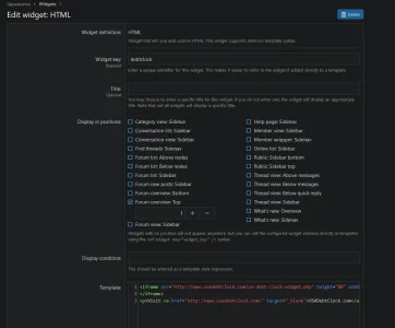

Thanks @Paul B. Any idea where I can get advice on how to add the widget to my forum? I think I put the HTML in the right place but I don't see it on the site through trial and error and I just don't know how to add it. Looked in the manual but for me, how to enable/where it goes is hard to understand/vague for a beginner.

First things first have you got a copy of the default xenforo style on your site? Does the widget show on the default style?
Your setup looks OK but I haven't made a widget in so long.

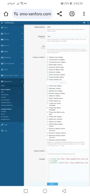

I've managed to get the widget to display on a demo install - the iframe appears to have issues though.
See attached. You may need a new embed code.

OK ignore all of the above. It's nearly 3am 🤦‍♂️
If your site is using https you will have to amend the iframe src to be https also. This worked for me on the demo install. See it in action here:
Your widget definitions in the xenforo control panel look fine. If it still isn't displaying it must be a style issue.

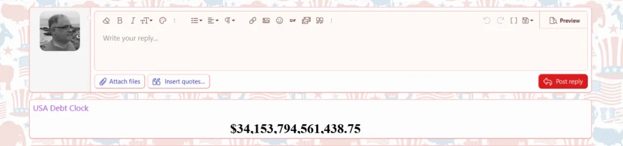

I just added it to my forum, for one specific (political) subforum/node only, below the quick reply box. It had to be https to work.
The debt is too wide for the sidebar, and that seemed to be the only position available for a sub node.

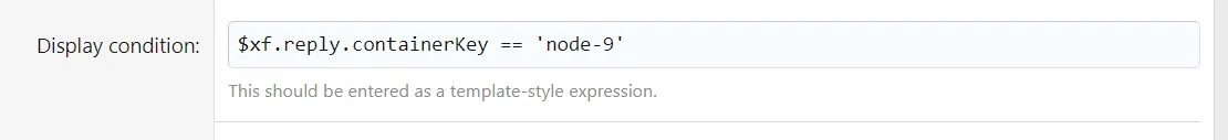

I also added this code in my Siropu Ads Manager, to display it on the top of that particular subforum. (If you have this product, its easier)
<xf:widget key="USA_DEBT_CLOCK" />
I'm using the "ABOVE THREAD LIST" location, within Siruopu ads manager. It looks like this:
