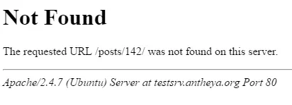

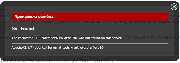

Could use some help. I have created a copy locally no problem.
I created an online test at pug.trumbower.com, no rewrite on and only the main page shows up. Can't seem to see the forum or any other pages. Need a few pointers to what else to look at.
Thanks
Thanks
Figured it out . Forgot about the Friendly URL setting in the admin screen.
