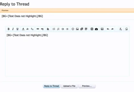

I am trying to find a way to just add highlighting (I guess another term is BG?) to BB Codes. I have visited this thread, and I tried to follow the directions, and I can't make it work, and don't know what I am doing wrong.

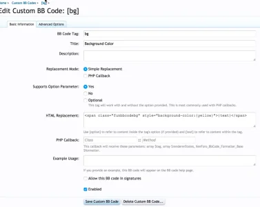

I have also been to the Custom BB Code Manager and just feel that is too much for me because all I really want to add is a Highlight Text BB Code.
Am I just whistling Dixie?
Can this simple thing be done in the Custom BB Code > Add New Custom BB Code

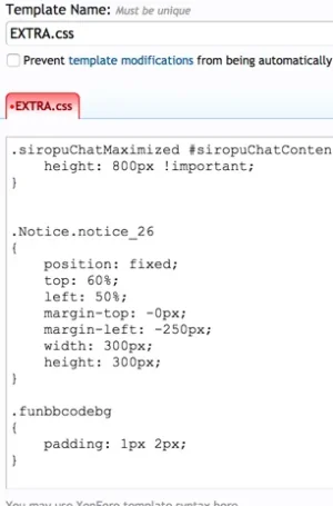

The class defined is like so:
.ctaBbcodeBg
    padding: 1px 2px;

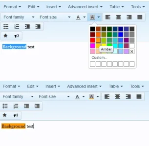

Why install a separate editor when it can be accomplished via the bbcode as mentioned above? Just curious.
Yes, an editor is "just" an interface and Bb Codes are managed by the XenForo parser and formaters. But the TinyMCE quattro has its own "highlight" Bb Code: "bcolor". Any other Bb Codes can be used as well but won't have the wysiwyg interface.

The HTML replacement is invalid and there should be no optional parameter if it is hard coded to yellow.

The items {option} and {text} are parameters that get replaced with whatever follows the '=' in the bbCode when used and whatever lies between the opening and closing bbCodes.
When you replace option with yellow in the bbCode definition, you are asking the software to give you the parameter "yellow" instead of the parameter "option" and yellow does not exist. I believe you want the code to always generate yellow in that example. If you leave off the curly brackets, that should work.
I am new here, so I am not sure why there is a class declaration in the bbCode definition. Since it is there in Brogan's example, I suspect it must be exactly the class that he declared since the class name needs to be recognized by the software.
I agree that the bbCode definition form is a bit intimidating. The example above helps quite a bit in the understanding if you know some of the basic rules of CSS and PHP.
My version allows for any colour to be used as the highlight/background, rather than a hard coded colour.
As you suggest, you can omit the option parameter and set the colour in the HTML replacement field, allowing just the tag to be used like so: [BG]Highlighted text[/BG]
