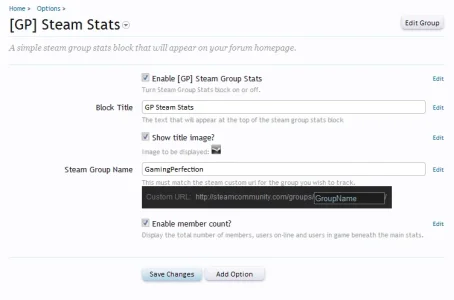

  8. I've updated the mod to now include a better description and image of what the GroupName should look like, as it wasn't immediately obvious before.
    [IMG]
    As far as I'm aware, this isn't currently possible due to a lack of user profile fields as there is no other way to pull a specific user's steam ID (unless it matched their forum name, which is unlikely). It does look like custom profile fields, or something similar, is going to be included in a later version of xF though, so it might be possible in the future. What sort of information did you have in mind, something like steamcard do;
