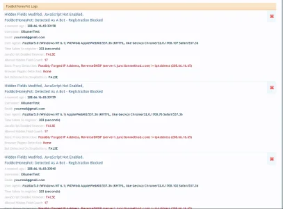

The logs get automatically cleared up weekly, so you don't have to delete them
No more than 3 months of logs should be added (since, it's quite unlikely admins will want to look at logs more than 3 months old)

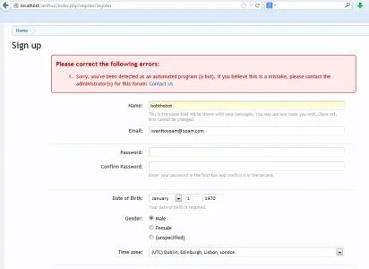

I have done so (you can delete the account woeitest) and this time it went ok. Thanks for updating.

The reason I haven't removed it, is because it's good to see the details in the fbhp logs, but should I get round to it, I will just pull that information from the core timer

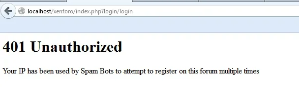

Since we have some very good methods to detect bots without a shadow of a doubt, I've added the option to cache the known bot IP addresses locally (This is optional, and can be turned off by setting to 0)
Known bot IPs are only cached if they have modified multiple hidden fields, have no javascript detected and have attempted to register very quickly.
Using cached Known bot IP addresses, we can then use a 0 query method to 401 unauthorised, or redirect them to a page of your choice.
We can therefore stop bots that try to brute force the registration page (after detection, they will not be able to resend another attempt for 48 hours by default), we do this with a 0 query method and should reduce server impact that bots usually have when brute forcing the registration page.
If you want, you can redirect these bots to a page on your site telling them that their IP has been stored for x hours as it has been detected as a bot.
However, if you redirect them to a forum page, bare in mind, brute force bots will hit this page over an over, I recommend leaving the default 401 unauthorised page
  • Cache known bot IPs of x hours
  • Prevent re-attempts for x hours (optionally redirect bots / 401)
For bots that keep re-attempting, have no js, have altered hidden fields and have tried to register very fast, the default page they will now see is this:
This is a 0 query method and low byte usage (not just 0 query overhead, buy actually 0 queries)
This should significantly reduce the impact of bots that hammer the registration page
You can optionally redirect them to a site page of your choice (but I would recommend leaving the redirect blank and just allowing the 0 query 401)
- Note, the 401 message is not the page bots / humans will see if they are not repeatedly detected as a bot, instead they will usually see this page on 1st detection:
