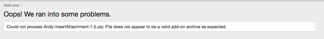

When I go to Admin -> Add-ons and try to install one of my add-ons using the new:
190159
button, I select a file like this
190160
Then I click the Upload button and I get this:
190161
I tried a couple different add-ons but I always get the same result. These add-ons were created on the same server and can install without issue the normal way when I just upload them to the src/Andy folder.

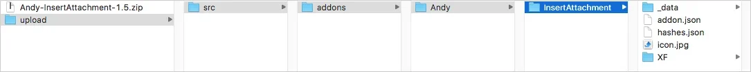

The full path is included. Here's a screenshot of the zip file which has been unzipped on my iMac.
190191
The add-on is built using the XF CLI command:
php cmd.php xf-addon:build-release Andy/InsertAttachment

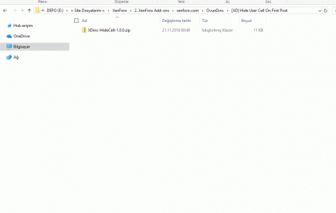

I did unzip, and then again zipped.
Problem solved.
I think it's a problem in compressing the add-on
The content of some compressed folders does not appear and I've observed that the add-ons in this case have problems.
