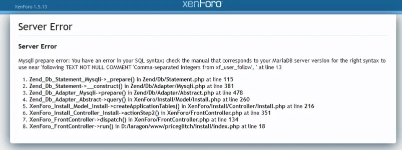

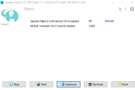

Using Laragon instead of XAMPP as it has built in support for composer etc and been working great for test installs for many different packages: flarum, wordpress, laverel
But trying to install xenforo i'm getting the following error:
for ref: php-7.1.1-Win32-VC14-x86
commenting out 1 line allowed it to install:
$tables['xf_user_profile'] = "
    CREATE TABLE xf_user_profile (
        user_id INT UNSIGNED NOT NULL,
         dob_day TINYINT UNSIGNED NOT NULL DEFAULT '0',
        dob_month TINYINT UNSIGNED NOT NULL DEFAULT '0',
        dob_year SMALLINT UNSIGNED NOT NULL DEFAULT '0',
         status TEXT NOT NULL,
         status_date INT UNSIGNED NOT NULL DEFAULT 0,
         status_profile_post_id INT UNSIGNED NOT NULL DEFAULT 0,
         signature TEXT NOT NULL,
         homepage TEXT NOT NULL,
         location VARCHAR(50) NOT NULL DEFAULT '',
         occupation VARCHAR(50) NOT NULL DEFAULT '',
         #following TEXT NOT NULL COMMENT 'Comma-separated integers from xf_user_follow',
         ignored TEXT NOT NULL COMMENT 'Comma-separated integers from xf_user_ignored',
Obviously not a suitable solution.

I'm currently using MariaDB 10.2.5 and a clean install works fine, using Sequel Pro as a client works fine and using the mysql command line works fine:
