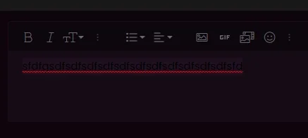

thenashy Active member Apr 14, 2021 #1 Hi All, How do I change the background colour of highlighted text in the editor?

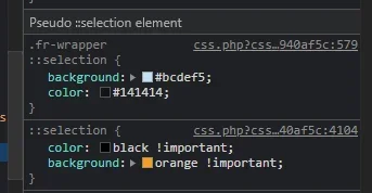

Paul B XenForo moderator Staff member Apr 14, 2021 #6 It appears in the inspector like so: The upper is the default, the lower is the changed code. Upvote 0 Downvote
thenashy Active member Apr 14, 2021 #7 Brogan said: It appears in the inspector like so: View attachment 250246 The upper is the default, the lower is the changed code. Click to expand... Awesome thanks, will help me next time I need to do this. Upvote 0 Downvote
