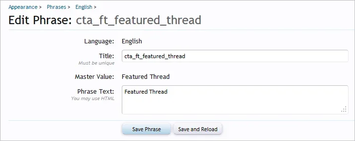

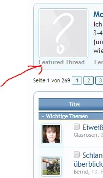

First: What is phrase for this:

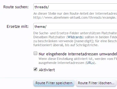

secondly:
Can I change the route and how. So my tests were not yet successful.

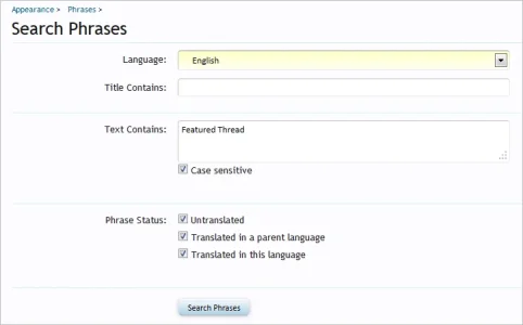

The easiest was to find a phrase is to search for the actual phrase text, so in this case you would search for "featured thread":

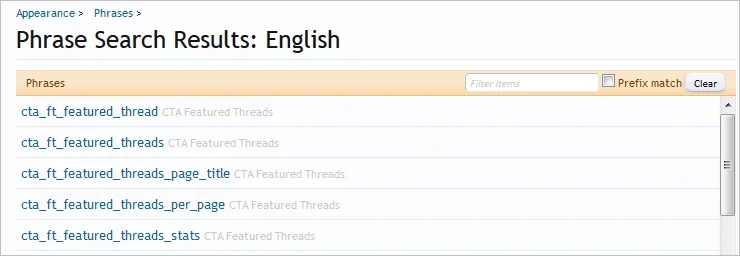

That will return a list of phrases which include that text:
In this case it's the first one:
How are you trying to change the route and what to?
