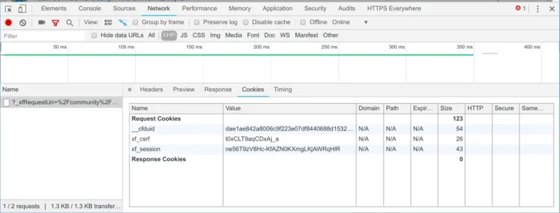

Hmm, I'm not sure then. As best I can tell, the only place in the code that would return that error is when CSRF validation fails with the error 'no_cookie'. Just to be sure, you can confirm the cookies are sent in the AJAX requests via the inspector:
Even if they're set in the client, they might not be sent on the request. Barring that, I have no clue :confused:
Indeed tracked it down to XF not sending the cookies with ajax requests.
