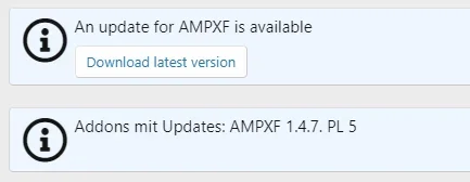

After updating an add-on, I get a second alert, that there is an update available (happens everytime)
What add-ons? I dont can reproduce this here and have many add-on installed here.
After updating AMPfx - its still shown as not up to date. Thats the only one add-on with this behavoir for me.

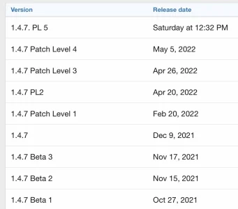

That’s cause the wrong versioning of the AddOn.
Patch Level 5 != PL 5
The coder have to name the version correctly.

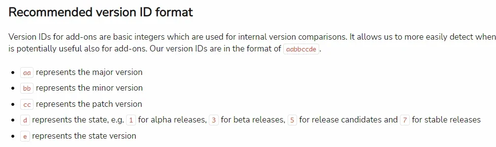

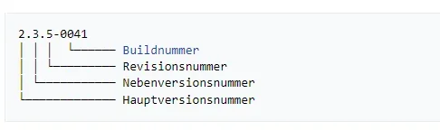

The name of the version should be not used, only the version number. The name is only decorating stuff.
This is not correct! The version number in software is not a decoration but essential and there are clear rules.
In PHP there is an extra function to compare software versions.
That XF additionally uses a version ID is nice. But I have no access to it. Neither here in RM nor in paid add-ons.
If you give the same information on both sides addon.json and RM, there can be no problem with the recognition. For that PHP has version_compare
Basically XF does with the version ID what you actually do with the version number.

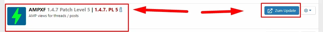

vs
I know - thats why I say its better to ignore this add-on. ;-)
It should be normal, that a add-on coder use a clear version number system. In this case, he dosnt do so.
Edit: I mentoid this at his support thread, I hope he read it and use a better versioning next time. ;-)
Will be fixed in the upcoming version. I have found the bug.

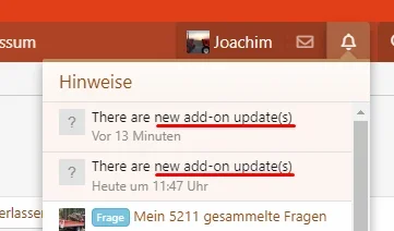

Happens for every add-on I use. Example:
2:53AM: Alert, that there is an add-on update (in this case it was s9e Media Sites)
11:37AM: I update the add-on
12:13PM: Alert, that there is an add-on update (and no, there is none)
