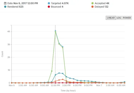

By way of comparison - my weekly email goes out via the XF mail queue, but I have a custom addon which sends via HTTP API on SparkPost and sends between 3K and 4K emails per hour according to the SparkPost stats.
I haven't benchmarked it using SMTP though.
I should also note that I'm not using the built-in "deferred" message processing - I disabled that and instead run a unix cron job to trigger deferred processing once per minute. Not sure if that would have an impact on sending throughput.
