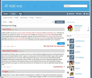

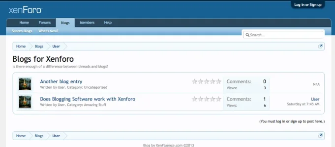

I'm still torn between this and XI Blogs.
My main issue with this is the appearance. I know there was some discussion but you do plan on working on the design anytime soon?
About the appearance
Here is a blog with XI Blog
Here is a blog with Better Blogs
I took the screenshots literally a minute ago from XenFluence and XfAddOns, you can decide yourself which one you like best.
Regardless, I am going to implement anyway all the design suggestions that were given to me here. Because there is valuable feedback there.
