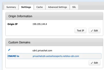

Has anyone here set up their xenForo forum to utilize maxcdn? I've had a go at it and so have my other staff members and we can't figure out why it's just not working. There's no integration plug-in for xenForo right now but it's a CDN, it shouldn't be hard to set up manually.
Edit: Okay so I've got the CNAMEs and what not right. A friend tells me I need to edit each .css file and the urls in it for the styles. What's left me confused is I have no idea exactly what to edit. I haven't got a clue with these files.
Here is what I have:

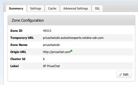

I've been using MaxCDN for a little over a year. I'm going to try and setup a new Pull Zone to see if that for some reason fixes it.
Replace the ’ quote with '
$config['externalDataUrl'] ='http://cdn.priuschat.com/data';
$config['javaScriptUrl'] = 'http://cdn.priuschat.com/js';
Here are the screenshots.
