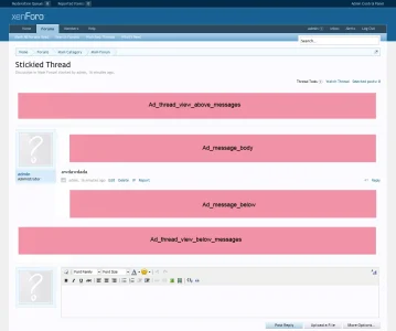

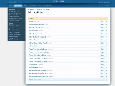

I've been using the demo, and I see there are multiple ad locations in the templates (ad_something else). I've been experimenting with putting in ads to see where they go, but I was wondering: is there something available that specifically describes the ad locations? Also, is it possible to put an ad only below the first post in a thread and not after each post?

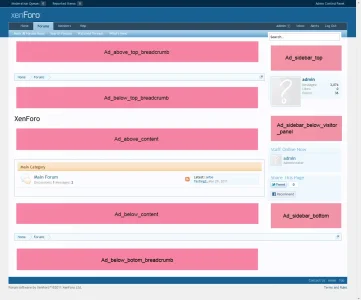

Above content is just above the node list, above that is the Forums > Xenforo > Node Name > Thread name navigation bar, above breadcrumb is above this.
What's the difference between "Above Top Breadcrumb" and "Above Content?"

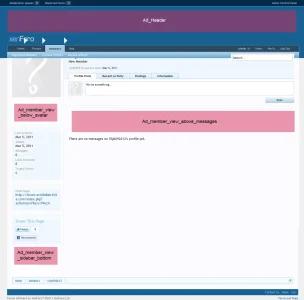

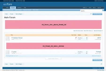

While I develop my add-on I need to know what locations are displayed to the visitor when in specific areas of XenForo. I took the time to edit each ad location template to display the ad template name, for testing. You can explore my development site to see where and when each ad template will be shown.

The name of the ad templates more or less describes where they go.
There isn't a document detailing them.

I'm keeping those up until I take official SS's for the release of the add-on. I want to leave them there for reference as there are six different possible combinations of displayed ad templates, depending on ControllerResponse TemplateName. I already have a list of each combination; something I needed to help keep resources used by this add-on to a minimum.
