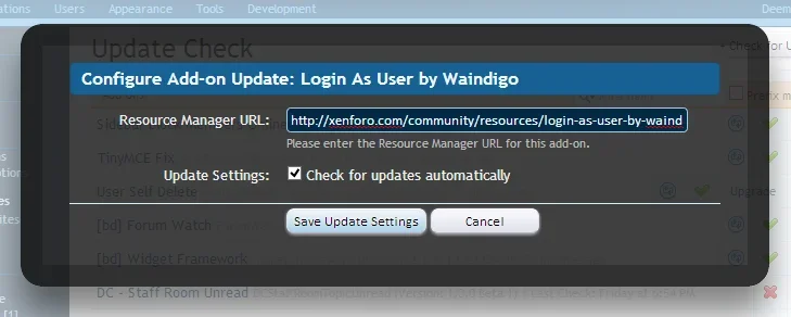

Don’t know if anyone has mentioned this, but after you upgrade an add-on it clears the Resource Manager URL from the below. I have to keep manually adding it back every time I upgrade one. Doesn't matter what browser you use.
Known bug, should be fixed in the next point release.

if i use the Update button the "Resource Manager URL:" get lost after the update

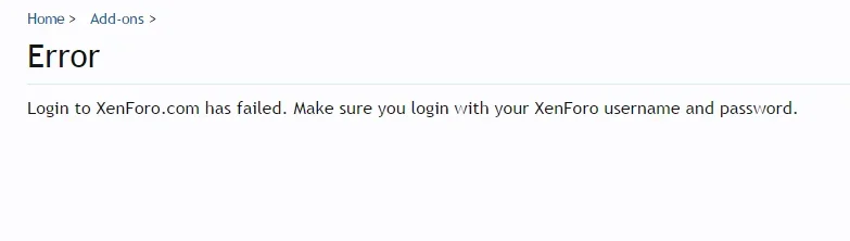

Hello @Chris D
I have to enabled "Two-Step Verification" then i check my localhost with "Add-on Install & Upgrade 1.3.1" i'm trying to url for resource is correct, enter install for url correctly then get error here.
I have to disabled TWO-Step Verification still works fine :|
