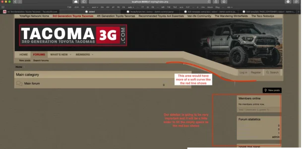

3. I've been messing with header styling. In this mock-up, do you think it would be possible to achieve the drop down area under the truck with CSS and/or HTML? If so, how would you approach it? I don't really need exact code as I'm sure I'll eventually figure it out if it is actually feasible.

Thanks, I was hoping to hear from you (even though I already asked you a very similar question).
I was doing my research on optimizing code for website load times and such so I figured the options it my first post would matter for that.
What is your impression of trying to code that header? Do you think it can at least be done?
