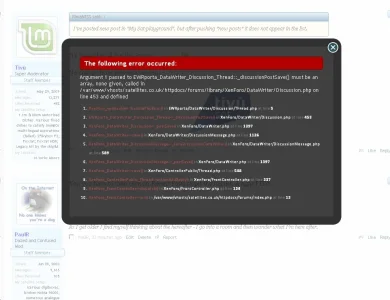

2) With xenporta enabled we are unable to post on the forum. we receive the following error.
Any ideas ?

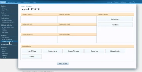

I uninstall it install it again no Promote this thread. Could you please HELP ME?
Permissions are OK and i have tried all possible combinations with blocs the last 12 hours. This is what is left to go live, there must be a way
Here is the setup what could be possibly wrong? Yesterday was ok
No Promote option
RecentThreads needs to be in Position: Top-Right or at least somewhere in the Portal Layout. You've got it in the Disabled Blocks section, so clearly you won't be able to promote any posts with it there.

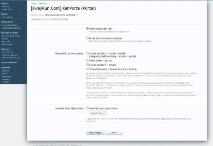

Hello,
I have two [home] tab on my navigation bar, the first one is the default one which is directed to the forum, and the second one is the portal one. How to remove the first one? I have a fresh installed 1.2 xenforo, and this problem didn't occur on 1.x
I have checked the Index(index>portal) and forum (forum-# > forum) box
Plus, when click on the forum tag, it shows "the requested forum could not be found". all forums now are not showing
even when I disabled the portal, now all fourms are still not showing, please help!!:cry:
admin.php?options/list/basicBoard > Index Page Route
set to: portal/

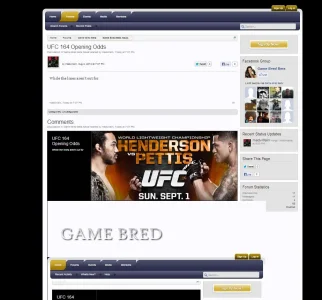

Hey guys I have most things working how I want. One weird thing that is happening is I'm having my homepage duplicated into my posts.
If you check out any of my news articles on my main page, gamebredbets.com.
I've tried it in different browsers and it still happens with the default template. Really weird. Appreciate any incite.

If you have "Index (index > portal)" checked, uncheck it. That should fix it.
When you want to check it back, go to layouts and create a layout for "index" first and turn on "Index (index > portal)".
