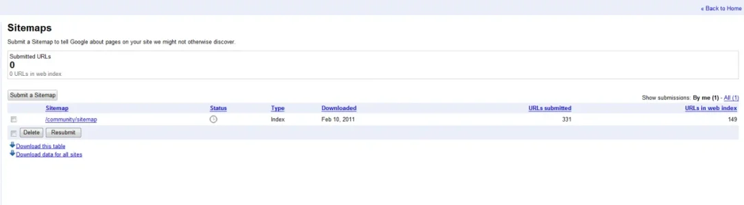

Hi Jaxel,
Since you fixed up the other issue I had with my sitemaps Google webmaster tools wont seem to accept my sitemaps? Its been like this for the last 24 hours and ive submitted and re-submitted a lot of times, still cant get the links to show up as normal, any ideas? cheers
Hi Jaxel,
Just wait for google... they tend to accept NEW sitemaps immediately... but already existing sitemaps take days.
