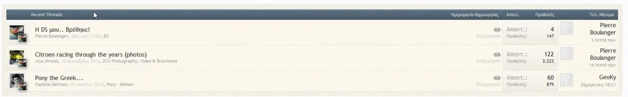

Curious if anyone has had any trouble with the RecentThreadsx5 block? No rush to get it working but new install of 1.2 and Xenporta 1.5.9. The first tab works correctly but subsequent tabs just load the forum list. Doesn't seem to matter what forums are selected etc.
EDIT - It actually loads the core of whatever the index page is. When I removed the homepage URL and put the portal as the main page now it loads the portal inside the other tabs. Stock and custom theme, no other addons for the record.

It's working correctly for me...
Thats not good then lol. Clean minimal install and not working but all the dirty sites have no trouble. Uninstalled and reinstalled the block. Choosing different forums for different tabs has no effect. They all load the same threads and then when I click on a tab a second time it does what it was doing back when I first customized it.
Tried pulling all the other blocks off etc. No difference.
EDIT - Alright I will have to take tomorrow evening to sort through all this but in the mean time here is a video of what I was experiencing:
I tried to do cache rebuilds etc kept erroring out and when i went to uninstall the add on it threw an error as well. Seems to be uninstalled but who knows. Might be a larger problem in play so I will wipe the test site.
With Xenporta installed I was getting this when I tried to run a cache rebuild in Xenforo:
ErrorException: in_array() expects parameter 2 to be array, boolean given - library/EWRporta/DataWriter/Discussion/Thread.php:35
Uninstall gave:
Zend_Db_Statement_Mysqli_Exception: Mysqli prepare error: Table 'tbgclanweb_xenforo.EWRporta_options' doesn't exist - library/Zend/Db/Statement/Mysqli.php:77
Afterwards cache rebuilds were working fine. Reinstall Xenporta cache rebuilds working fine. Install the block. Everything is fine except the block behavior has not changed.
EDIT 2 - Clean install of Xenforo, Installed Xenporta, created a couple test forums and 2 test threads. Installed and configured the Recent Threads x5 block. Previous behaviour still there. Clicking on tabs causes the index page to load within the block. Changing the index to the portal displays the behavior previously observed in the video. Each tab lists whatever the first is set to and then subsequent clicks load the page in the block.
