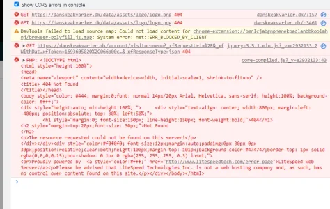

I moved my forum, but it seemed to break it a bit. Where and how can i correct the url. I can no longer access admin page or threads. o_O
Log in to the ACP directly at /admin.php and update the Board URL.
Seems like admin.php was missing. Strange, I think something happened under transfer...
Is there a way to validate, that all files are present?
I believe this can be fixed, with just moving the installation zip file in and just cancelling overwrite so all missing files get added?
I've seen the answer around here is just to download the latest version and to re-upload all the files in.
That seemed to fix the issues.
