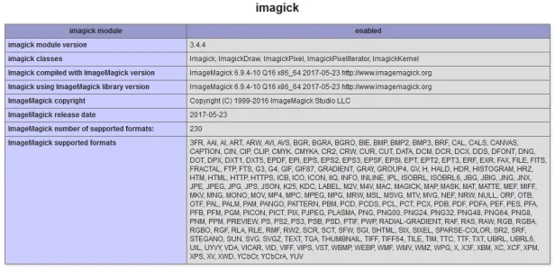

Imagemagick PECL extension; mass panic apon uploading a gif, but if you pulled back the curtain, and rolled your dice just right, you now are one of the few people who somehow have a gif avatar, despite it being seemingly impossible.

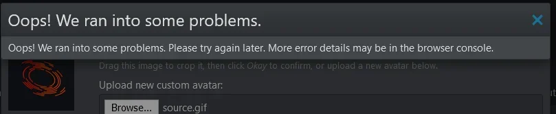

but, you might ask, what kinda error does this fine fella get when he uploads a gif, ill tell ya what. a boilerplate error that doesn't even properly tell you that the server is temporarily busy, try again later.
BUT, you might ask, what does the the ACP error log tell ya; jack.
then, you might be thinking, what does your host's logs say; jack. (not even a file in our logs folder)
then, after this line of thought, you might think to ask me about the version of my Imagemagick PECL extension;
and as far as I am concerned, that's as fresh as I know it to be.

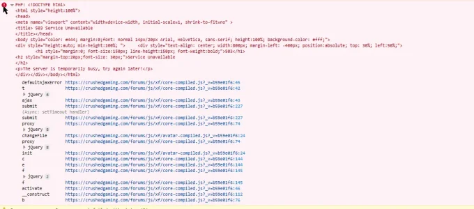

- which is probably why I'm completely oblivious to what all that word cram about an AjaxError, doubt that even with my lack of experience here, that its genuinely what's the problem, but who knows, I can't summon wizards yet

If you still get a 503 error then your sysadmin host is going to have to start looking into it.

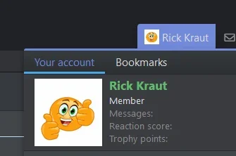

ok, i got a weird one, several hours later, I can say that the thumbs up animation is now set, so I guess it did upload, just that it got to it really slowly? I passed out at some point so, not entirely sure when it happened, just know its up now
was wrong on that, see image

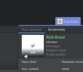

I have a genuine distaste for this issue now, I uploaded the ostsee.gif as my avatar, to make sure it works, that was the last thing I did (it worked)
but, uh it got overwritten, no idea why, no one changed it for me
(this is forums wide now, not like the above post)
My best guess is that what ever manages avatar uploads got overwhelmed from one of the other times I tried uploading this gif, and buried the upload later into the queue to handle later, and it got to it about now. (notably not an intended 'feature')
I'll see if this is repeatable in any way, but I doubt that it will be apparent right a way, just like what happened here.
EDIT: in the avatar editor, it display's as ostsee.gif, no idea.
