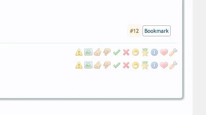

Hello. I've just upgraded to 1.1.5 my XF installation but I've a problem since I've a double icon line for each post when I hover the post like you see in this image

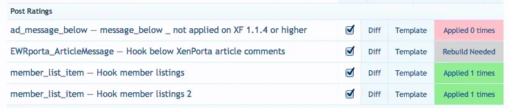

I've noting in red as you can see here

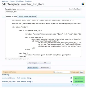

I've clicked to rebuild templates but the double bars are always there, so I've checked if the template has manual edits but there aren't, as you can see

Hi, I've just upgraded xenforo to 1.1.5 (from 1.1.3), plus updated XenPorta_portal (to 1.5.8), and I believe one of those actions has caused a double-up of my PostRatings bar at the bottom of each message, as per:
Can anyone point me in the right direction of which template might be causing this issue??
