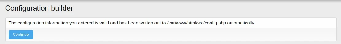

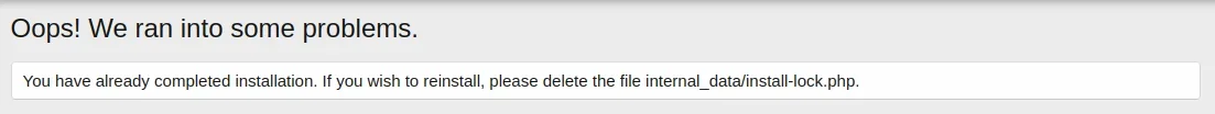

Now, after set the database information, it says that config file has been written, and when I click continue, it says that I've completed installation (index.php?install/step/1b).
But no installation was made, no table in the database, also there is no install lock file. Any solution for this?
It would be down to some kind of environment issue. See \XF\Install\Helper::isInstalled and \XF\Util\File::installLockExists. Essentially \XF::fs()->has('internal-data://install-lock.php') returns true, meaning the lock file does exist as far as XF is concerned. Barring custom mounts or stale Docker volumes, I'm have no idea what would cause this.
I found out the issue.
Due to the docker configuration, I have folders outside the main xenforo installation such as ./.data where the install-lock file and other configurations were. After deleting this information I was finally able to install XF.
