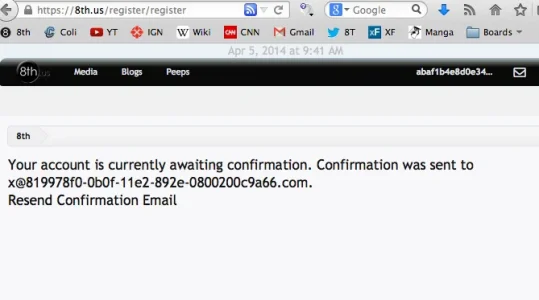

I get this error when using the latest paid versions of TAC and FBHP. I installed it manually uploaded to the server etc.
@DRE can you tick the option in FBHP to use: Legacy Mode (as a test), I suspect you will still have this issue, it doesn not happen with FBHP (alone or with other add-ons that override actionRegister correctly)
Nothing has change from previous versions, have you installed another add-on that might affect the registration area.
It sounds like something is overriding the actionRegister and not allowing other add-ons to use this area (not passing through the parent values)
If other add-ons override and do not pass through the parent, they can break all other add-ons that use the same area.
If you can search through your files (I use agent ransack, but you can probably use a windows search for this), search though all your xenforo plugin files that contain the text " public function actionRegister" ... let me know what they are, and I can probably identify the offending addon for you (if they're free / public)

Yup that's the one cocking things up.. they use actionRegister() and don't pass through the parent, so that will balls up every add-on that uses actionRegister() with an order that is lower than it's self...
Even with my beer goggles I can see that
I can tell you what to add to fix it, it' not really your job to though
I also understand why the addon developer might do it, it's not easy to extend actionRegister, since as soon as you call the parent, you allow the user to be created (unless you have returned within your override). The first time I extended it, I also duplicated this function, but it's a greedy thing to do that will break all other add-ons
Just do this, to this file:
librbary/MandatoryLocation/ControllerPublic/MandatoryLocation.php
find the function
public function actionRegister()
at the very end, where it says
return $this->_completeRegistration($user);
instead replace that text with this:
return parent::actionRegister();
(since the parent will call the overridden _completeRegistration anyway, and calling the parent will allow other add-ons to run that use this area, and then they too can call their versions of actionRegister.. allowing this add-on to be compatible with other addons as FBHP and many other addons are)

Yeah it was my first addon which I wrote a couple years ago when there weren't any other hacky plugins that messed with the registration forum. I might consider doing something similar to what you did, which would avoid the duplicated code (assuming I can get it to work).
Speaking of which, given that my addon is currently duplicates the original registration function, wouldn't calling " return parent::actionRegister();" cause issues with registration, or would that not be an issue since _completeRegistration() is not being called?
  • Like
Reactions: DRE
@ceribik
Yeah, you'll want to take out this too "$writer->save();" and allow the core parent to do make the actual save, egh.. extending actionRegister is messy
calling parent::actionRegister(); at the end allows plugins to be called that extend this function (in the acp defined executions order), then I think the parent
