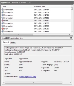

WAMP - Apache crashing issue while be crawled.
I've been trying to track this problem down since last year and have finally pin pointed the problem to Xenforo. Now before you shoot me down in flames here me out. I've been suffering with random crashes in apache for a very long time and been looking closely towards a server problem but this is no longer the case. I did 3 crawl tests on the same server with the same configuration options using the same database. I used a package called Netsparker (Crawl only settings) and came up with some interesting results. I also have a VB and Flash blog installation on the server which i tested very extensively and they completed the craw test with no crashes within the apache log. However when i did the test on Xenforo the server keeps restarting with a 255 restart. I'm still unable to track down the problem URL's that's cause the crash. This is not just a local problem but an external too. I have tested the new 1.1.0 b4 and does far better then 1.0.4 but still crashes.

[Fri Nov 04 12:42:00 2011] [notice] Parent: child process exited with status 255 -- Restarting.

Unfortunately, the errors you provide are vague, a 0xc000000000005 releates to an access violation error, the best I could suggest is running an indepth memtest to see if you may have a fault there.

So much trouble for something so simple. If you had tried googling for Apache php5ts.dll it would have told you that this is a very common error with WAMP installations on windows servers. The issue is caused by when php is used as a compiled Apache module. Apache crashes because the php module does something which the operating system, windows, does not allow it to do and it terminates the entire process, meaning Apache.
In most cases the solution would be to use the latest WAMP / XAMPP versions. It's something very difficult to pinpoint to the exact fault though, unless you happen to be able to debug windows dlls.
And for the record it's not a XF error. It will happen with even a simple phpinfo() file for servers where the fault happens.
Thanks for the insight sadikb (y) . I did call phpinfo() and produced no system errors. I can understand what every one is saying but i still wish to know why Xenforo is crashing Wamp and Vbulletin is not. If this was a total Wamp problem would they not both be doing it.
My suggestion would be to try an alternate LAMP setup. Install Xampp and see if the same error occurs.
