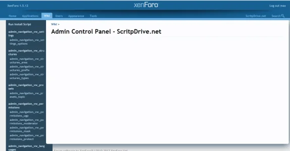

I was able to move past step 7, but somewhere along the installation process, I got the following error:
“You don't have permission to access /admin.php on this server.”
And now I’m unable to log into my Admin panel. I get the following error:
Edit: I’m able to log into my admin panel, but I see the following error:
pegasus
I've never seen a message like that before from XenForo. I've checked XenForo's stock phrases, I don't see anything like it. Since the error is wrapped in XenForo style, it seems like some add-on you have installed that adds "security" to admin.php, rather than your webserver actually not being able to access the file. You might have tripped that security and gotten yourself temp-banned. I'm not familiar with your other add-ons, so I can't be more helpful than that.
EDIT: I see you've edited your post. VaultWiki usually looks like that when the cache rebuild at the end of the installation did not complete. The installer was probably halted when you encountered the previous error. You should re-access the installer and click the "Continue" link to rule this out.
I have disabled all my add-ons, except for Vaultwiki & Vaultwiki routes, but I’m still getting old error with step 16:
Forbidden
Additionally, a 403 Forbidden error was encountered while trying to use an ErrorDocument to handle the request.
Could this be a server related issue? Should I contact my host?
pegasus
If you appear to be getting banned from all pages on your site for a few minutes (can't even get there normally), then this might be a server security issue where the server itself is banning you for some reason. The reason might appear in one of your logs, or perhaps your host might be able to tell you why you keep getting banned.
max_d
I can access my site just fine, and I have never encountered this error before. This only happens when I try to install your add-on.
I’ll ask my host. See what he says and then report back to you.
