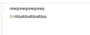

I'm doing as specified by this thread, except going into the nitty gritty of it:
http://xenforo.com/community/threads/bit-of-an-immature-request.42852/
So I've extended XenForo_BbCode_Formatter_Base and am doing the following:
PHP:
<?php
class GreenText_BbCode_Formatter_Base extends XFCP_GreenText_BbCode_Formatter_Base
    public function filterString($string, array $rendererStates)
        $parent = parent::filterString($string, $rendererStates);
        $pattern = "/(\n|^)>(.*?)(\n|$)/";
        if (preg_match($pattern, $string))
            $replacement = '<span style="color: #789922">$i</span>';
            $string = nl2br(preg_replace($pattern, $replacement, $string));
            Zend_Debug::dump($string);
        return $string;
However, I can't for the life of me figure this out! I get this in my posts:
Should I summon the gods of Zeus or...
You use $1 not $i; I'm also fairly certain it won't work if it's in ' instead of " like you have it.
